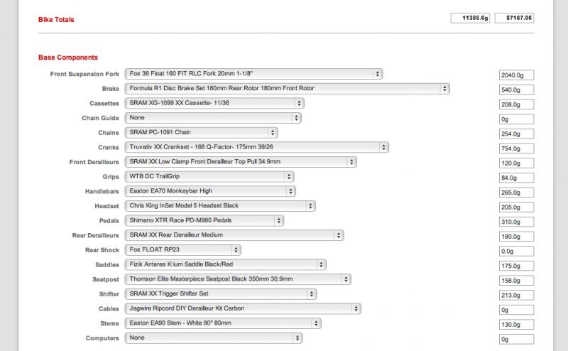

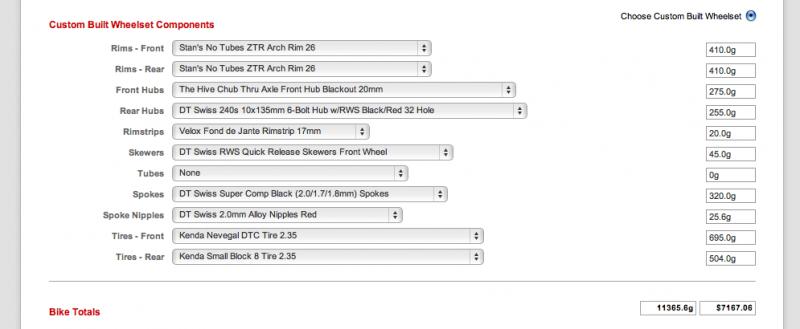

Итого (все не влезло в один скрин, поэтому по частям):

Компетитив Саклист оценил все это счастье в 11366 грам. Но почему то не учел вес троссиков. Предпологая что троссики весят 100 грам, мы все еще не дошли до отметки в 11500.
И роспись по компонентам.
FRAME:
     Santa Cruz Nomad Carbon with selected components from XX package Black w/Gold Large
Front Suspension Fork:
     Fox 36 Float 160 FIT RLC Fork 20mm 1-1/8"
Brake:
     Formula R1 Disc Brake Set 180mm Rear Rotor 180mm Front Rotor
Cassettes:
     SRAM XG-1099 XX Cassette- 11/36
Chain Guide:
     None
Chains:
     SRAM PC-1091 Chain
Cranks:
     Truvativ XX Crankset - 166 Q-Factor- 175mm 39/26
Front Derailleurs:
     SRAM XX Low Clamp Front Derailleur Top Pull 34.9mm
Grips:
     WTB DC TrailGrip
Handlebars:
     Easton EA70 Monkeybar High
Headset:
     Chris King InSet Model 5 Headset Black
Pedals:
     Shimano XTR Race PD-M980 Pedals
Rear Derailleurs:
     SRAM XX Rear Derailleur Medium
Rear Shock:
     Fox FLOAT RP23
Saddles:
     Fizik Antares K:ium Saddle Black/Red
Seatpost:
     Thomson Elite Masterpiece Seatpost Black 350mm 30.9mm
Shifter:
     SRAM XX Trigger Shifter Set
Cables:
     Jagwire Ripcord DIY Derailleur Kit Carbon
Stems:
     Easton EA90 Stem - White 80° 80mm
Computers:
     None
Rims - Front:
     Stan's No Tubes ZTR Arch Rim 26
Rims - Rear:
Front Hubs:
     The Hive Chub Thru Axle Front Hub Blackout 20mm
Rear Hubs:
     DT Swiss 240s 10x135mm 6-Bolt Hub w/RWS Black/Red 32 Hole
Rimstrips:
     Velox Fond de Jante Rimstrip 17mm
Skewers:
     DT Swiss RWS Quick Release Skewers Front Wheel
Tubes:
     None
Spokes:
     DT Swiss Super Comp Black (2.0/1.7/1.8mm) Spokes
Spoke Nipples:
     DT Swiss 2.0mm Alloy Nipples Red
Tires - Front:
     Kenda Nevegal DTC Tire 2.35
Tires - Rear:
     Kenda Small Block 8 Tire 2.35
